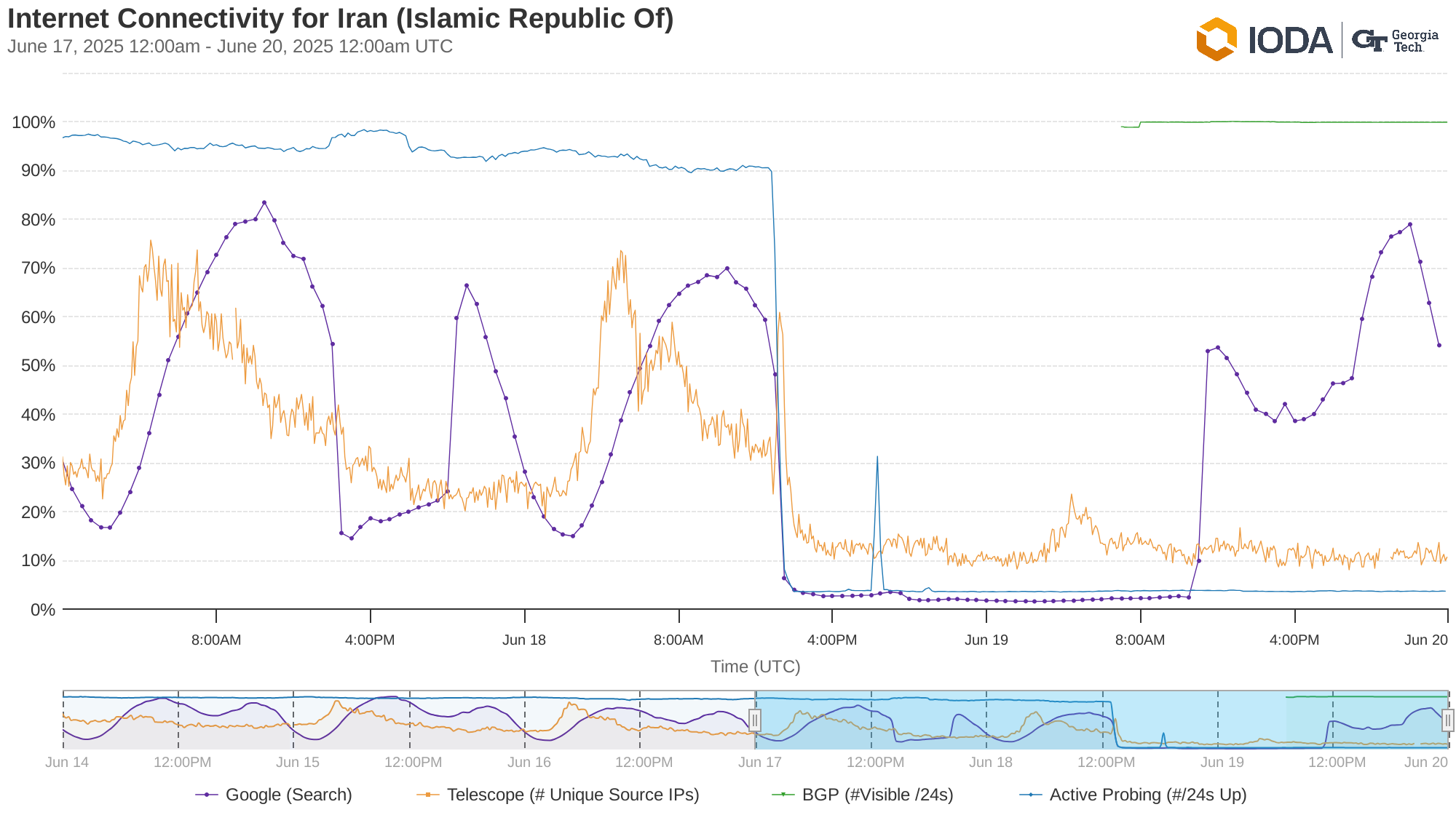

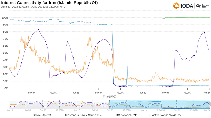

This IODA graph shows measurements that reflect the shutdown.
https://ioda.inetintel.cc.gatech.edu/country/IR?from=1750118424&until=1750377624

There has been a shift in the situation since about 2025-06-21 02:00 UTC, about 28 hours ago. The shutdown hasn’t “ended” exactly, but it’s qualitatively different now. There are still great many blocked destinations, but not as many as there were the past 3 days. For a short while after 2025-06-21 02:00, I could even some web sites hosted in Iran, which I cannot any longer (I didn’t keep track of exactly when it worked and didn’t).

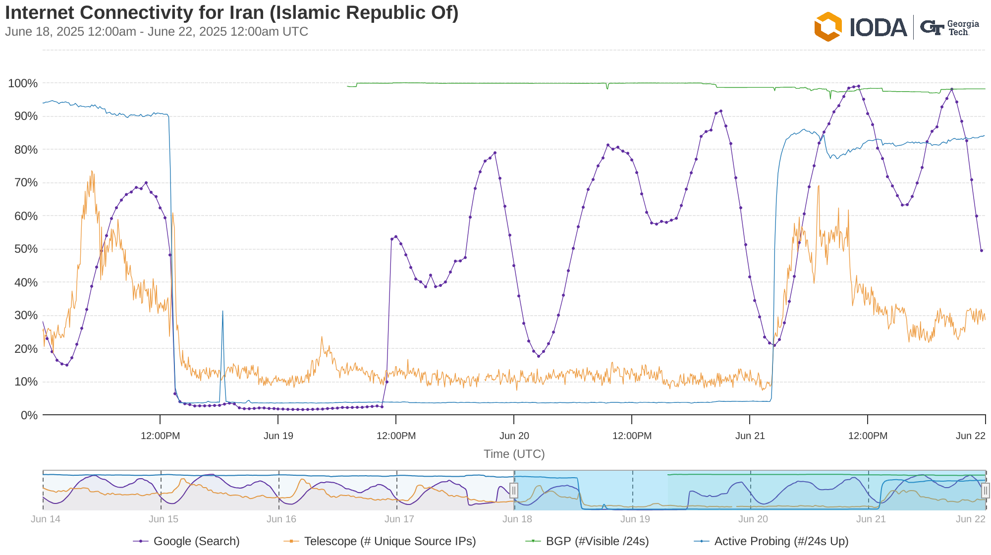

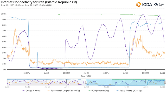

Here’s the IODA graph. Notice the abrupt increase in Active Probing and Telescope signals early on 2025-06-21.
https://ioda.inetintel.cc.gatech.edu/country/IR?from=1750204812&until=1750550412

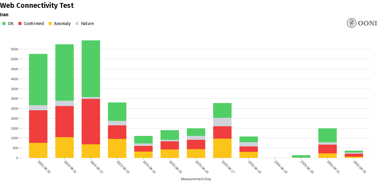

Here’s a graph of OONI measurements. Notice a gap on 2025-06-19 and 2025-06-20, and a recovery on 2025-06-21. (These charts count reported measurements: during the shutdown, OONI clients in Iran couldn’t upload their measurements.)
https://explorer.ooni.org/chart/mat?probe_cc=IR&test_name=web_connectivity&since=2025-06-10&until=2025-06-23&axis_x=measurement_start_day&time_grain=day

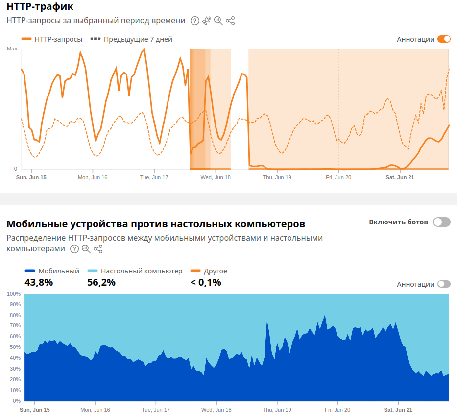

In the 4th day of #Iran’s govt-directed internet shutdown, the picture is now complicated. Most large networks are still down but some are now carrying traffic.
Back online: TCI (AS58224), Rasana (AS31549), Neda Gostar (AS39501), Pars Online (AS16322)
Still down: Irancell (AS44244), MCCI (AS197207), Rightel (AS57218)
Temporarily restored: TehranServer (AS213807), PEP (AS213732)
Partially restored: Abrarvan (AS202468), Respina (AS42337), Tebyan (AS48434), AminIDC (AS48147)

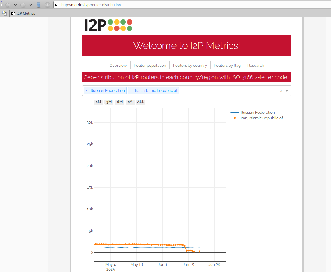

I2P
http://metrics.i2p/router-distribution

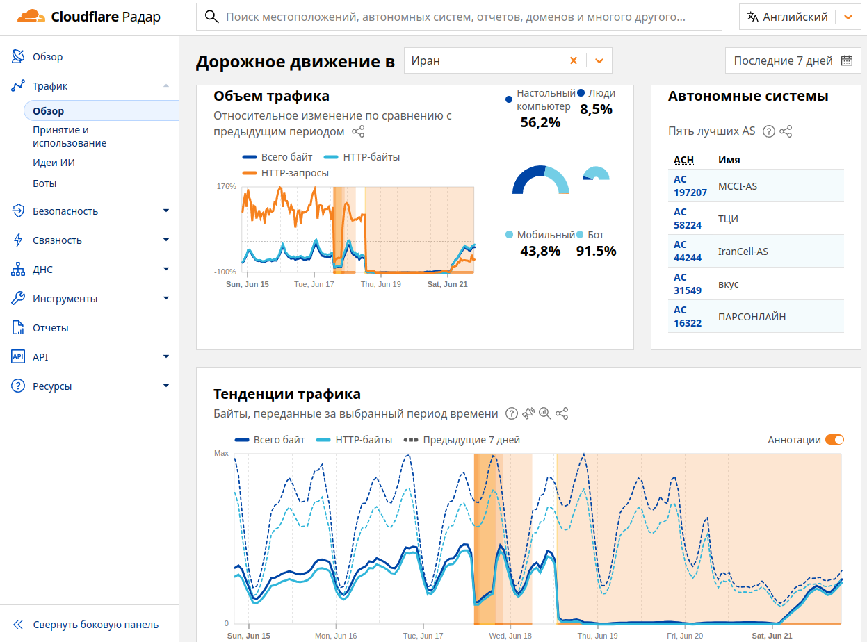

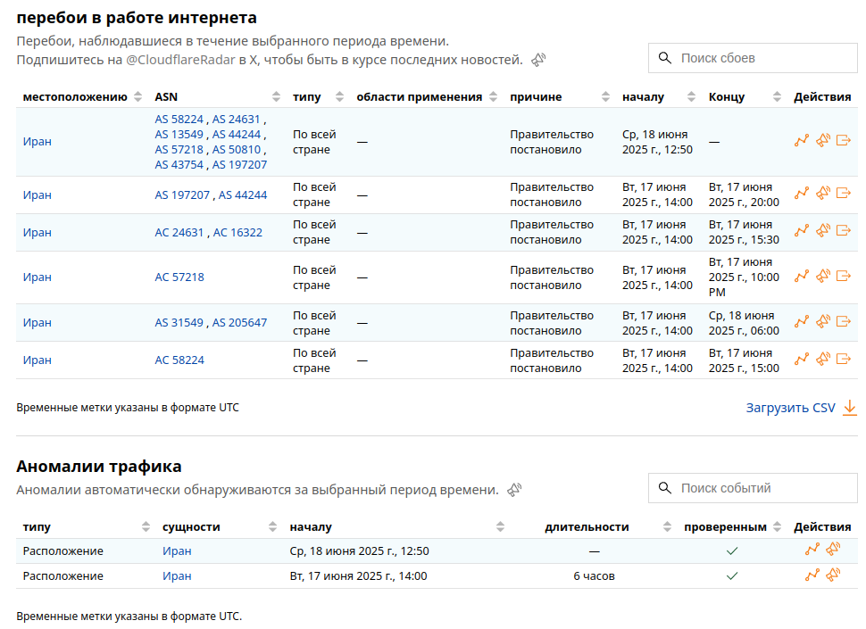

Cloudflare
https://radar.cloudflare.com/traffic/ir

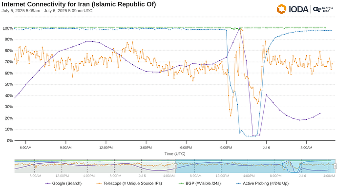

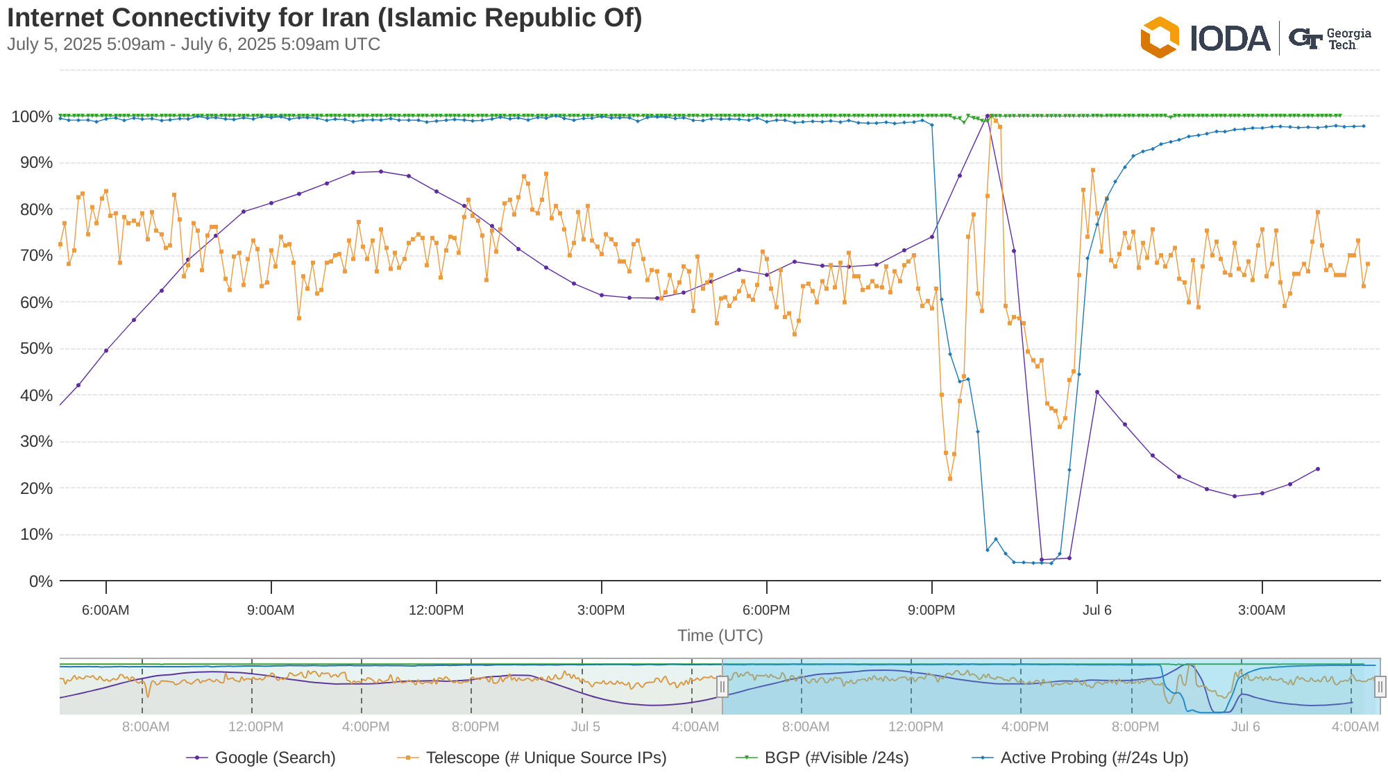

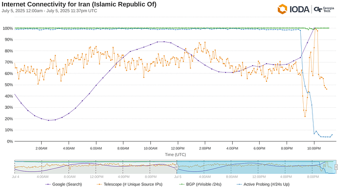

There are signs of a second shutdown starting 2025-07-05 21:00 (3 hours ago). I haven’t seen much technical information yet.
https://ioda.inetintel.cc.gatech.edu/country/IR?from=1751673656&until=1751758676
https://mastodon.social/@IODA/114803134755818667 2025-07-05 23:06
IODA shows what looks to be a complete Internet outage in Iran, according to our Active Probing signal. Reports indicate Iran’s domestic Internet is cutoff from International connections.
Follow connectivity in Iran: https://ioda.inetintel.cc.gatech.edu/country/IR?from=1751669534&until=1751755934
EDIT: this one lasted only about 3 hours.
https://ioda.inetintel.cc.gatech.edu/country/IR?from=1751692169&until=1751778569
